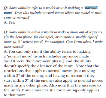

    Riders of ruin does not grant retreat and charge. A normal move that takes place within 3 is a retreat and is defined as such in the core rules. The faq linked also clarifies that point.
    This specific language was probably to differentiate this type of move from the "retreat" charge reaction thats coming in 3.0.
    Itll inevitably be irrelevant as they probably get retreat and charge some other way, but riders of ruin does not inherently grant it.

    One of my gaming buddies disagrees with this assessment:
    In other words, whilst you are right in that the rule does not grant retreat and charge, it does grant the unit the ability to ignore being within 3" of an enemy unit for the purposes of starting a normal move. Cycle-charging may thus still be a thing so long as they have the space to do so.

    There is no difference between a normal move that starts within 3 and a retreat. It's simply two ways to describe the exact same thing. There is nothing about the language that would grant exception and there's no way to define a retreat without calling it a "normal move that starts within 3."
    Your friend states "it says they can do a normal move so they can do a normal move" and they are because every unit that retreats is making a normal move. Making a "normal move" and a "retreat" are not separate actions, and if you separate them it brings up a lot of wonky issues. The FAQ linked above really does help clarify a lot of this.
    Also, I see this whole "specific over core" brought up all the time incorrectly. Specific only trumps core when the two abilities can't be congruent. This is not one of those cases.
    Unfortunately, as of right now, Blood Knights do not have retreat and charge.
